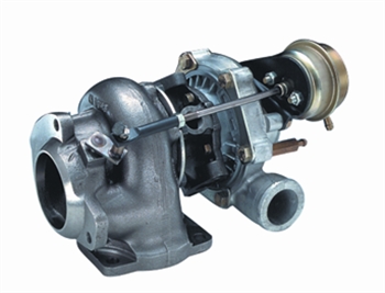

Til orientering, så er det den her vi snakker om:
https://www.burtonpower.com/dets_product.aspx?PartNo=TURBOTSF03&Submit=Find+It%21&PSet=99
TURBO384%20Turbo.jpg [ 47.69 KiB | Vist 2126 gange ]
